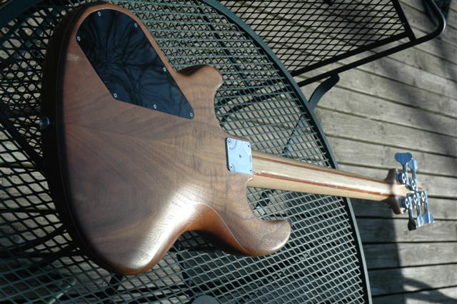

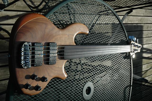

Okay, a buddy called who is a bass player. He asked me if I could fret a bass that is now a fretless. I said sure, but it would ruin the resale value....
He goes with that and bingo drops $3700 for a used Wal Bass out of the UK. After going online with his idea to fret a fretless bass, he hears the same sentiments from Wal Bass owners...... don't do it!
So now my friend has two Wal fretless basses. Two to three year wait on a new one he sez.... So we are not going to cut fret slots on the Wal neck. I'm going to make him an entire duplicate neck for his Wal. Does anyone know the species of wood which makes up the two center laminations in the Wal neck?
The other woods appear common, mahogany, and maple. The wood in the center appears to be very fibrous, and yellowish white in nature. It's not something I'm familiar with. I'll post pictures for later.
Thanks for any info you can give or places to look for information. Maybe I should contact Wal basses? They might just be willing to share that information.

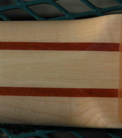

Basically the wood in the center two laminations are the mystery wood. I recognize of course the mahogany and the maple, but the center wood is somewhat of a mystery to me. What do you think it may be?
While we are at it, we may as well go to an original duplication of the woods. Very interesting bass guitar. TIA for any help. Wood guys? Paddy thanks for the offer to contact Wal direct, that would be helpful.

Bruce
From what I can see It has the look of Air Dried Holly.
PostPosted: Mon Feb 27, 2006 4:54 am
Or Ash
PostPosted: Mon Feb 27, 2006 5:19 am
My vote would be ash as well. At first I didn't think is was pourous enough but then I thought again. Another vote might be hickory. It can have that same look but it's very heavy and I don't think anyone would use it for neck wood.

I've never used Ash or Holly, so it looks foreign to my eye. It has a yellowish cast to it, but the finish is very clear.
The mahogany and maple are the correct colors in the photos, so you can guess the center wood is as well. Clear finish, no tint that I can tell.

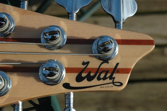

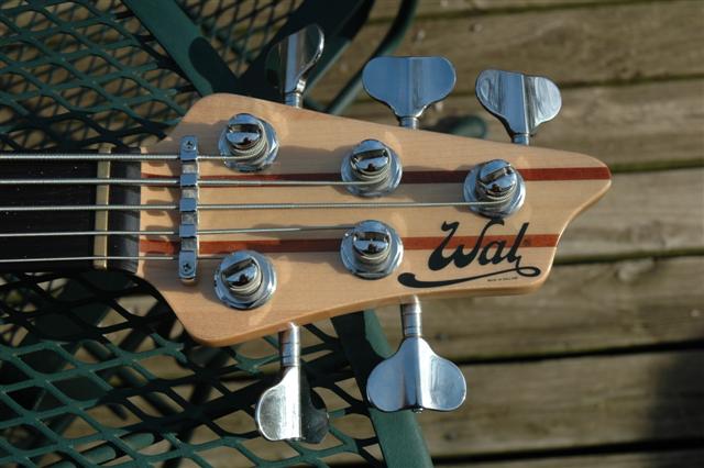

O.K. These wood may sound crazy but wal used these for necks. Hornbeam in the center Mukalungu strips and them hardrock maple.
Good Luck!   Addam Stark38775.5898842593

Bruce, Hornbeam is a common hedgerow tree in the UK Carpinus betulus, I believe that it is also cultivated as a park and hedge tree in the US. You also have a native US Hornbeam, Carpinus caroliniana. It's a hard, fine grained timber from which the old nine-pin skittles games in the UK were made and is used in piano making. I used Hornbream for the fingerboard and soundboard frets on my 7-course lute. Lovely timber, nice for carving.

Maybe a bit on the heavy side for a complete neck Bruce but would sure make a good laminate as in this bass. Good and hard enough for a lute fretboard. But gut strings aren't too demanding! It's like Lime in that it can be carved in any direction with or across the grain.
